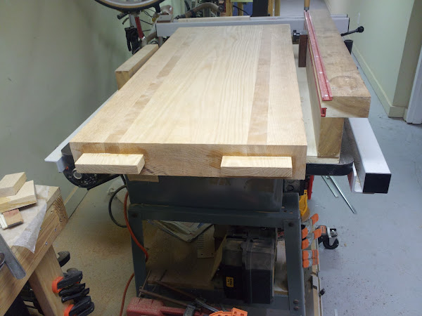

Another option: float some tenons into the existing end:

Dude! Of course! You’re my hero!

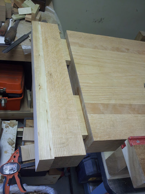

I figured I’d post an update. The floating tenons gave me exactly the look that I had wanted. They were a PITA for various reasons, but I’ve got the second end glued and clamped now. Nearing the home stretch.
I struggled getting the ends parallel with the top. On the first one I didn’t realize that the rough sawn/reclaimed side of the breadboard was not perpendicular with the bottom and ended up with holes drilled on the press that were angled down. Pooh. I corrected it my planing the tenons to allow the end to be tilted and loaded it up with glue. Yeah, I know… The second end went much better, but with both of them I realized that I was a dope and made the bread board mortises the same length as those on the top, which was stupid. Instead of a tightly fitting (side to side) tenon in the BB end the edges just float. Oh well. With half a gallon of glue it should set up just fine and nobody will know…
