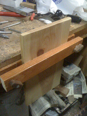

I made a “bench vise” and I use the term loosely, for holding the board for cutting the dovetails.
Bench Vise
It seems to work pretty well for that although I haven’t tried cutting yet. At worst I can clamp the board to the bench, or maybe my table saw or something.
