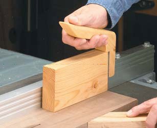

I use two GRRippers in combination, but I also use the pictured pushstick. It has a replaceable hardboard tail hook. I use it with a featherboard when it seems like a better idea than the GRRippers.
Douglas Bordner
3427 posts in 962 days
770 days ago
Very nice pushstick, Tom. I like the extra height with the handle. BTW,Nice manicure. Next time I need photo work holding something I’m sending it to Alberta for hand model work. Gotta be better than these wrinkly ole sausage fingers of mine.
