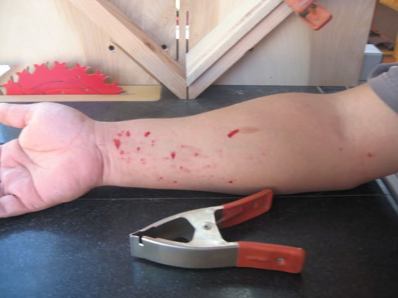

Today it’s been a day that I had learn a huge lesson on the woodworking life. I was cutting some splines for a frame for my in law’s.
Everything was going smooth as planned, until….... I decide to change the C-clamps that were holding the pieces of maple on the gig for some spring clamps. I thought I was wasting too much time using the C-clamps so I just wanted to go “a little” faster… boy I was wrong…..
I made the huge mistake of not double checking were the clamp were positioned related to the height of the blade, eventually it was just a “little” too low. So I thought everything was ok and I decided to go for the cut.
Instantly I felt something on my arm that was just a little bit different that saw dust, hundreds (well may be not hundreds but a lot) of tiny razor sharp metal chips with a little bit of blood.
Immediately I turned off the saw and my first reaction was looking for the “lucky” finger, no kidding I actually counted my fingers 2 times just too make sure they were all still attached to my hand, it took me a few seconds to realized that my fingers were ok, the actual deal was on my arm.
Eventually there was some blood (not much) but some, nothing that hurts a lot but it really made me realized the constant danger that we are involved every time we step into the shop.
It took to my wife 15 to 20 minutes to remove all the “chips” out of my arm; we actually counted 73 little tiny chips.
The lesson I learned, always double check everything and when you think everything is ok, check again.

Just a thought, might want to trash the blade, no telling if one of the teeth will come off at a bad time now that they have been in direct metal contact, at least a time or two for each tooth. Glad no serious injuries, get well soon, BTKS
25792 posts in 1292 days
1 day ago
Hope everything is healiong up fine. It would be nice to have plastic clamps for times like that.
