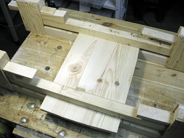

Here’s another way to flatten glue ups you can make at home.
From my woodfolder
View NathanAllen's profile
NathanAllen
63 posts in 40 days
37 days ago
Nice, I dub that jig the caul and maul, even though they’re technically wedges.
