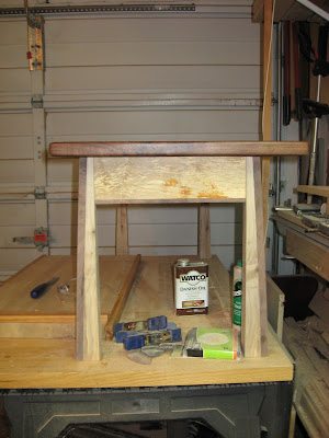

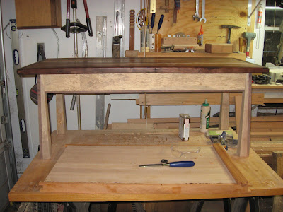

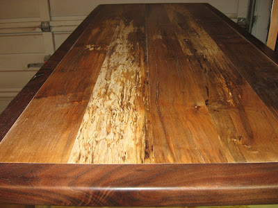

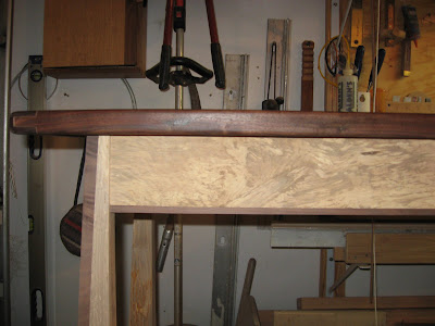

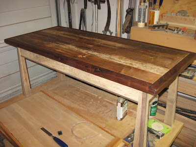

Hey All,
Okay this is a question for all you style mongers out there (ie: everybody) I am not really concerned about the strength of the legs but I’m wondering if I ought to put stretchers in here for more stylistic flair…or not. Now I know some of you might say, “well it just depends on what you like…” That’s not good enough for me, what I’m looking for are YOUR opinions. Stretchers I’m considering putting in would consist of two short stretchers on each end of the table then one 4 or 5 inch wide stretcher connecting the two end stretchers.
Anyway chime in if you would, I’m curious to hear some opinions.
Thanks,
~isaac
here’s some pics of the table as…not finished with oil on the bottom yet.
From Spalted SweetGum & Walnut coffee table

I would not put stretchers in unless the have a unique design or contrasting wood something other than just straight stretchers. The table is already beautiful with wonderful wood and great design.

I like it the way it is.

If you are looking for opinions, here goes.
I would say no streachers since the legs get larger going down streachers might tend to make it look bottom heavy. Unless, well, you are expecting a really big guest to use it for an ottoman regularly.
I like the two tone wood in the legs and the wood contrast in the top. Let that shine.

Issac…..I agree w/ scottishrose as well as the others. The table is not for sitting, therefore, theres hould be no racking. If your table legs tapered down (top to bottom), cross strecher might work., but that’s another day. Stay w/ what you have.

Looks like a good strong table. No Stretchers

i agree: no stretchers. they would at best not be much seen, and at worst make the lower portion look to cluttered.

yup ,
no stretchers ,
its already busy enough .
sure is beautiful !

At this point I would say “no ” to the stretchers, cause like Chris said, it looks like you’ve already finished it, and already have a finish on it. But— in the building process, if you were going to put in a bottom shelf, then that would have been the time to do it. Otherwise, now you would run into problems , and it would look like “add-ons” came later. Leave it alone!! I’ve made coffee tables with and without stretchers, and bottom shelves, but as you know, it all has to be done in the woodworking/ building. That’s my 2 cents.

only the tabletop is finished. the skirt and the legs aren’t finished with anything yet and the top is not yet attached…so the possibilities are still endless, almost.

I think that the only type of stretcher that would work with that table would be a large cross stretcher from diagonal leg to diagonal leg where your smaller top rests in the middle.
On a side note, that sweet gum is floating in that walnut frame, right?

my wife actually had the same idea, she said that any other type of stretcher might seem too plain.
and castigate me if you will, but no the sweet gum isn’t floating in the walnut frame, it’s all pocket holed together. i know, i know…i may have problems with movement but with as muggy as it is here in deep East Texas (where yesterday it was 85 with 95% relative humidity and today it’s in the mid 70’s with 90% humidity and next week it might even dry up a bit) anyway it seems like any problems i could be looking at would’ve at least manifested a little bit by now. the top has been together now for about a month, in my garage shop.

I love the look of the table, as it is now. It reminds me of Cypress trees growing up out of the water. Because of the Asian influence, I have to think they would add more structure to the table. Arched “I” stretchers or a diagonal cross-stretcher, possibly capped off with a small interior shelf seems appropriate to me. I think the former is more basic, but you’ve already gone artsy, so the latter would be going all the way. I’m thinking a couple of Sketchup drawings might be in order. You’ve made such a beautiful piece, and you still seem so conflicted. I totally empathize…

I think you also need to consider what you’re going to use the table for. Would stretchers get in the way of, for example, chairs? Also, what do you want to attract attention? I think the pattern of the sweetgum against walnut draws the eye. It’s a beautiful job. You don’t need to add extra detail to draw the eye away from the top. But that’s my opinion.
