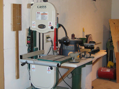

Another vote for Grizzly. I purchased the optional riser kit along with some Timberwolf blades and this thing cuts like butter!!
