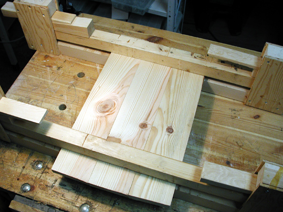

3053 posts in 919 days
73 days ago
I use a simple board clamp to keep the edges from buckling and then the appropriate hand clamp to keep the glued edges together.
I think lot of trouble starts out with too much pressure in the glue ups.

View dustbunny's profile
dustbunny
330 posts in 193 days
72 days ago
Hey Bob #2,
I like the board clamp set up you made. Consider your design stolen, I’m making one.
