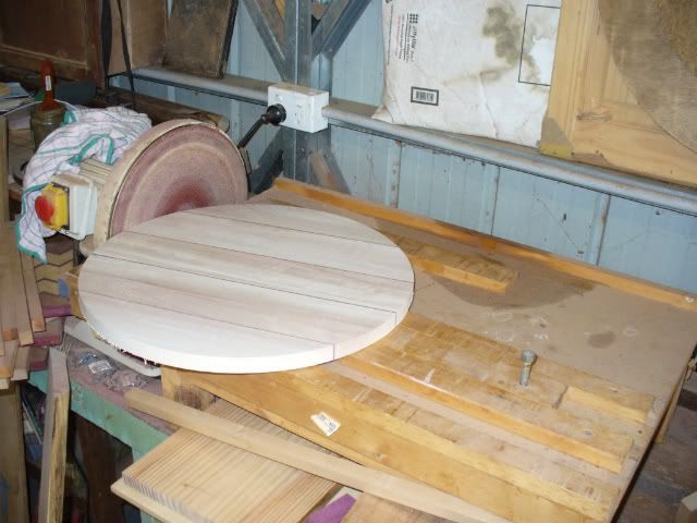

Hi Mike.. I made this circle sanding jig as part of my circle making for the Lazy Larrys.. the rest of the info on the circle cutting jig and how to make it are in the blog.

Great Larry! The idea of a circle jig did in fact occur to me and I really appreciate having a ready-made solution from you. Good on you mate!

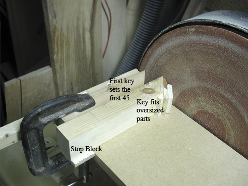

I made my sander and use it primarilay for truing up segment pieces for segmented bowls.
From segmentAlbum

Thanks Bob, that is my primary reason for buying this sander. It will mainly be used for sanding segments. I already have a jig made for that purpose.
