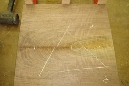

I wanted to combine the project with gifts for two different weddings this summer. I opted to make them from Black Walnut, with a “Rodel” kind of look. I think Walnut is regal on it’s own, so I tried several methods to add the detail shown in the original design and ended up going with inlay of the same wood. I think it adds a complementary, but still subtle detail.
I book matched the tops and started gluing up, I’m not sure if the wild grain will detract from the overall look – but, it’s too late now!
I laid it up for a concealed drawer – I think I will use the same inlay pattern on all four sides –
Instead of a shelf, I’m using a lattice-work to span the bottom stretchers – I am going to try to cut it to a cloud lift pattern…
For the breadboards I flushed them with the top and extended out a bit (I just like that look) with 30 degree cuts on the ends and on the plugs concealing the screws. I laid out the tongue to be able to screw the breadboard into dowels (long grain).
That’s where I’m at so far – lets see, how many days do I have left…..Man, I need to get BUSY!

This is lookin’ great schroeder. What type of finish do you have planned? Something clear?

Thanks – The finish, I’m really partial to Sealer, Poly and wax – I don’t want to change the natural color of the wood.

how wonderful! I love the table top!
And I really like the lattice. NICE

Nice going Schroeder, I like your presentation. Your going to have two beautiful tables when there completed. The lattice work is going to look real nice. Walnut is the greatest in my book.
I wouldn’t worry about not finishing in time, I think you’ll make it.

I was unfamiliar with Rodel’s furniture. Thanks for the reference. If your finished table come even close to his values, your wedding gifts will be terrific. Judging from your previous posts, I’m confident that the final result will be outstanding. And please, don’t rush your work to meet an artificial deadline.

I’m trying not to rush it Don, but I saw as I was posting this blog that I left no room for the cloud lifts when I put the drawer runners in…(sigh)...a little “re-fit” work to do. Yes I am a huge fan of Rodels work.

Schroeder; The table looks great. I always love patterned wood so I like the tops. When I go to the sawmill I tell them I want the strangest wood they have.

Those are some beautiful tables. I like the subtle design you did with the inlay. I thought I was seeing things at first or that you had some new way of putting a pattern on walnut. You must finish at least one of these for the contest, you deserve it. The lattice work is a neat look, too. I wish I would have thought of that.
