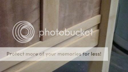

I am laying out the legs now to accept the panels and rails
This is where the center stile will fit into the top and bottom rail.
The tenons are only 1/4” and the panels will float in the rails and stiles. The strength that holds the sides together will be from the rails, the top and bottom shelf which will be 3/8” X 1 1/4” tenons pined from the legs.

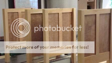

I got finished with the 4 side panels and dry fit them ready to do a final sanding and finish. I will wait to do the finishing after both night stands are done but that may have to wait until I get back from vacation. So here are the sides.

We are back from New England and I have been in the shop for the last two days. I made changes to the side and back panels and I hope its not to bold but I like the look so far. I have finished all the sanding on the 8 panels plus the rails & stiles using mineral spirits after each sanding to raise the Grain and check for any small scratches. The rails & stiles are cherry and the panels are now quilted makore. Tomorrow I will lay out the legs for the mortises and dado to lock in the panel then draw cut and sand the arches at the bottom. I will finish the panels before the glue up because they will not be glued in place and be allowed to float for expansion and contraction.

I have 4 more panels for the back and I will try to get the best match for the sides. I don’t know how I am going to even the color, some have pink some have brownish and red mixed in but all are from the same two boards and matched as best I could get them. They do even out when wiped with mineral spirits and may be drying as you can see the blotch in the cherry from where it has dried and some may be the quality of the camera. Two photos are the same panel in different light. Any suggestions? I had thought about using the same stain (very light) I will use on the cherry to do a test.

There are 12 panels total and they are 7-1/8” X 14-7/8” so I think that would be to much but thank for the offer. If need be I will cut new ones from one I have 8” X 4’ 8/4”. I have some red die I will ad to the natural stain and see what happens. Now that I am looking at it in these close ups I will have to take another look I do not remember them looking this bad.

Here are the 2 sets of the sides for the night stands dry fit with the Quilted Makore panels which I am not all that happy with because of the color variations. I may try to stain and blend them so the contrast is more consistent and if that don’t work shopguryl was kind enough to send me the veneer shown in the photos above.
I still need to cut the arches at the bottom of each panel I will have to be real careful, I know I should have done this step before assembling the rails and stiles but forgot so its critical not to mess up.
