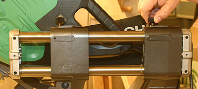

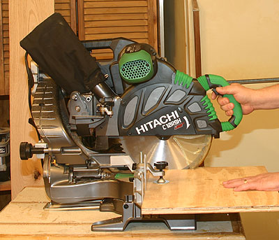

When I picked my “Hitachi 12 SCMS I did so because the sliders are mounted in front of the rear attachment to the base making the distance from the wall a lot less as the sliders don’t have to travel back behind the station.
Makita is a good choice too . My needs were a bit different.

Bob – if you have limited shop space, the front mounted sliders is definitely something to think about. Thanks for sharing.
