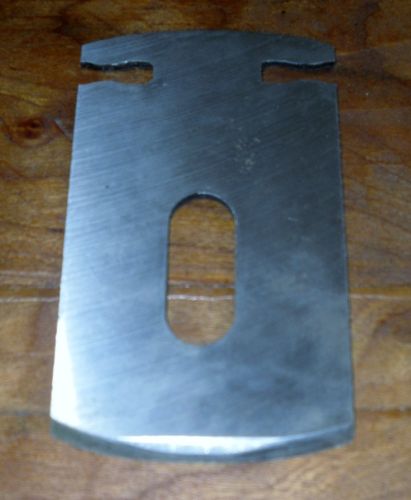

There is one up there at H-F that does rate a review. In fact, it was even a “Star” on a Stumpy Nubs show awhile back…
@ $8-10 each, not a bad little plane. Better yet, it CAN be made into a very good scrub plane…
It’s iron is a bit thicker than your “normal” irons, and the adjustor can angle the iron for a bevel cut, IF you don’t grind it as a scrub. Seems to be on a level with a Stanley #40. The wood being scrubbed in the picture? Beech!
A 3” radius on the camber, and you have a wicked little beast of a scrub plane. @ $8-10, one can afford to have a second one set up as a “normal” #3. Buy two, that = one Stanley #40….
