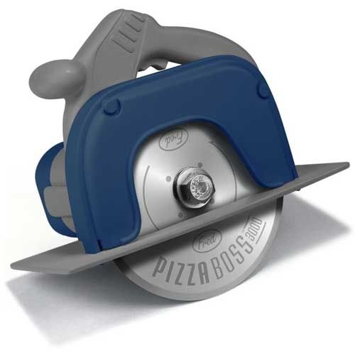

That’s a cool pizza slicer with a personal touch.
Very good tip on the threaded insert.
I might need that when I make my BBQ cover handles in the next couple of weeks.
Also, here’s another cool pizza slicer.
