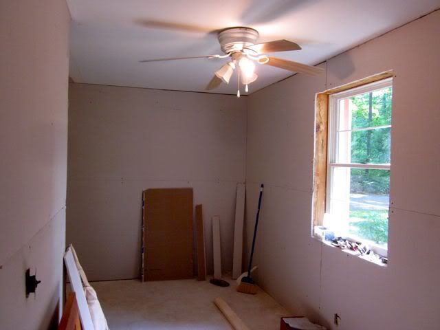

And the boss is happy to have it started. You’re right, everyone else first. What’s that old saying? “the cobbler’s son is the last to have shoes?”. Actually I retired from teaching after 30 years about 5 years ago. I found that if you charge just a little less than people trying to make a living at this stuff you can get lots of work. So I’ve been trying to start my own place since 2005. It’s finally arrived!
Here’s a little pict of the part I’m at… This is just part of a bedroom. Long way to go in a place that was built in the 50’s. Old family home on the lake.
