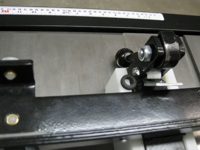

Another minor problem with my fence: On my saw, the fence lock lever seemed to need a lot of force to lock the fence unless I jiggled it a bit. Closer inspection revealed that it was binding against the lock foot and actually trying to bend the foot before sliding on by and locking. A magnet embedded in the lever pulls the lock foot away from the rail for easy gliding when unlocked, but in my case the foot wasn’t going entirely back to vertical when it snapped free of the magnet during the locking operation. It needed help from a spring of some sort.
Unable to find a compression spring with fine enough wire and small enough diameter to do the job, I improvised by stuffing a 3/4” O.D. grommet into the top of the lock foot. A pretty crude rubber spring, but it worked. The part of the lock lever sliding against the foot had a rough cast surface, so I ground it down smooth and polished it up and put paste wax on all the rubbing surfaces. After that, the fence was a joy to use.
Grommet in Position to Insert
