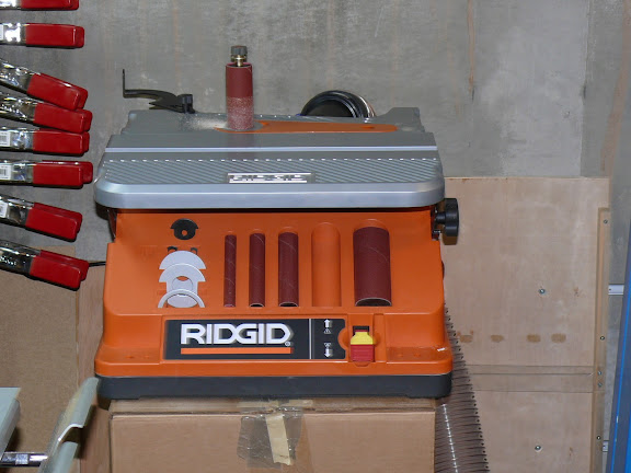

View NBeener's profile
NBeener
4856 posts in 1343 days
#9 posted 846 days ago
Try to find somebody who doesn’t truly like theirs … MORE than they thought they would, AND …. that doesn’t USE it more than they thought they would.
One of those Ridgid gems.
And … yep: I love mine, too. One day, I’ll improve the dust collection, but … no major hurry ;-)
