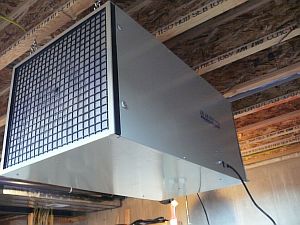

Getting the unit unboxed and hung on the ceiling (with her help) took about 30 minutes. The unit is heavy so I definitely recommend two people. I turned it on high thinking it would be loud but was surprised at how quiet it is. I gave it a quick test by creating some dust on my tablesaw with the dust collector off and was amazed at how fast it sucked the offending particles of plywood up and out of the air. The remote control feature is great, nice to keep the remote close to where I am working and turn it on when needed. I also love the timer, really nice to set it for an hour or two when you are done to help get the crud out of the air.
My workshop is in the basement of our house right below the living room, we have hardwood floors so nothing to absorb any nosie that it would create and she has never complained when it is running. I honestly cannot tell it is running when I am in the living room.
I have noticed that the amount of dust on things the next day is very minimal. I have not used it enough to have to clean the filters yet.
Overall I am very happy with my purchase (had a hard time buying something that isn’t considered a tool).

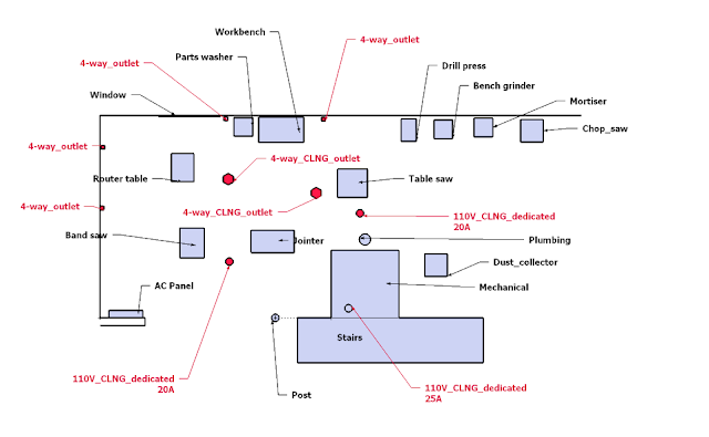

Mine is … more or less … in the center of my shop—probably >8’ off the ground, between the two 4-way ceiling outlets, here:
It seemed like the perfect location, but … with the benefit of some experience … probably isn’t.
When using the table saw, for example, I am right between the saw and the JDS unit.
No point in pulling it all right past my face, on its way to be cleaned.
Typically, though, I wear my respirator, and then use the JDS to clean the air after I leave the shop—either for a break or for the day. My shop’s in the basement, so … I just bring the remote control upstairs, with me, and then turn the JDS off after a while.
Cheaper and easier than a timer, thinks me :-)
