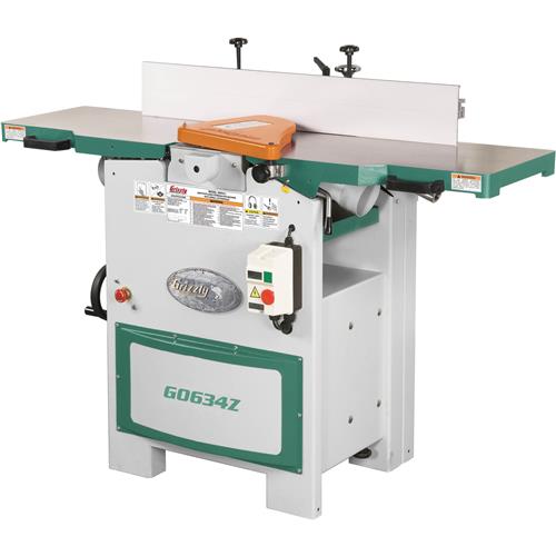

I’m looking really hard at this grizzly combo:
G0634Z. It is hard to find many people who have it though.
