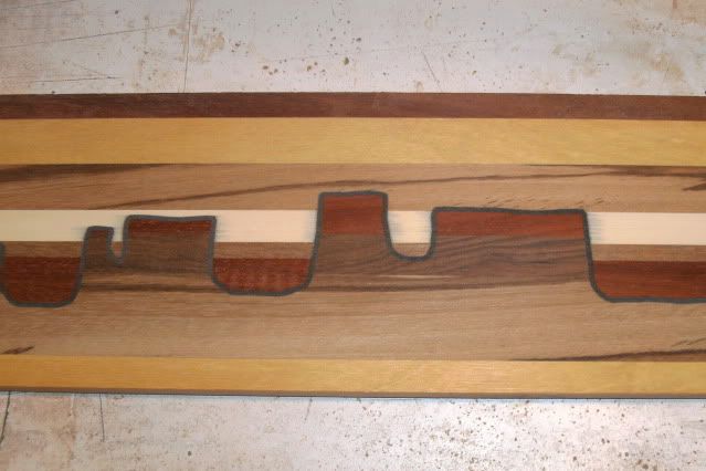

here is what happens without sealing the wood first ,
( this isn’t the finish , just for the in-size , and surrounding surface )
i just spray the whole surface , and get it in the in-size well .
the epoxy wants to be proud of the surface .
it all gets sanded later , including the sealer .
