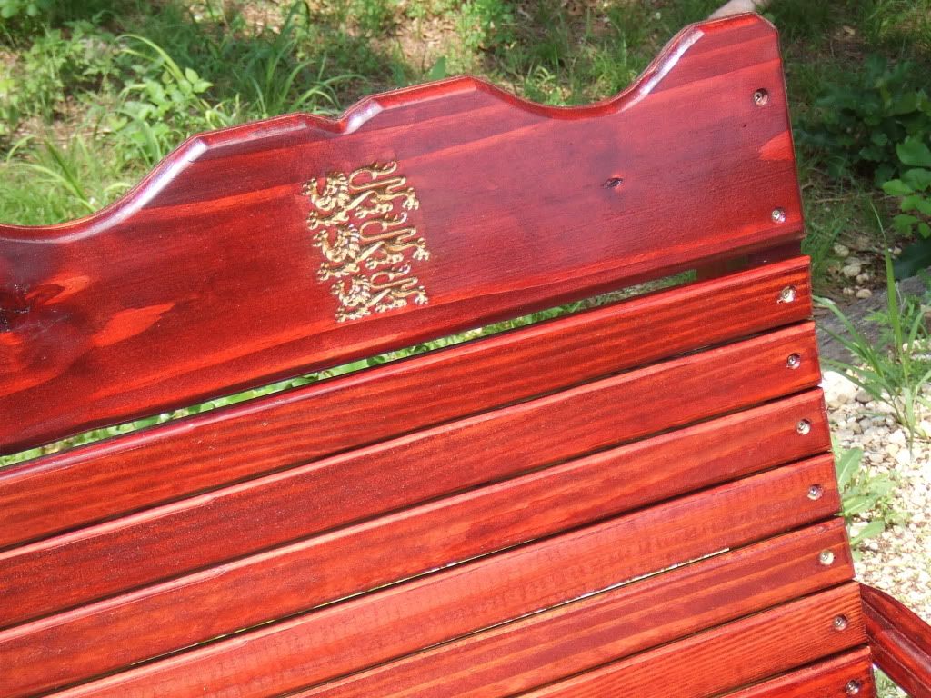

What you are seeing is the actual tool path layout for the cnc router. The tool is a 60 degree V groove router bit with 1/4” shank set to a depth of 0.125”.
The cnc is a Shark Pro which Rockler sells. There are 2 models for different capacities. 13×24 and 24×24, I have the 24×24. You fit a Bosch Colt router using 1/4” shaft bits to it. The machine comes with an excellent high end CNC design program – V-Carve Pro which is supurb. I run the program and generate the G code on my laptop (WinXP) which is connected to the sysytem via a USB port. This is a nice system for light use and not to be confused as an 8 hour a day production CNC – they cost bunches of money. The machine will interface with any other cnc software as will V-Carve Pro interface with any cnc machine because they all run the same codes.
I have not used mine much at all, but if you take a look at a post I made showing a Yard Chair set then you will see the headboards have rose string cut by the cnc and another chair with 3 heraldic lions.
