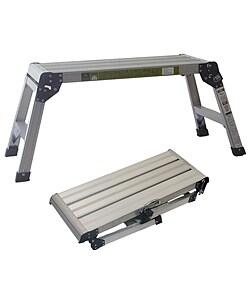

Great use of available space, just be careful on that ladder tho.

Good point.
I use a folding aluminum platform for alot of work including accessing this rack.
Much like this one much safer than a ladder in my opinion:
Since I’m a little over 6ft tall, can reach the top layer of lumber easily on that.
Not a big fan of ladders.
Flashbacks to dads home built 20 ft wooden ladder that was used quite a bit when I was a child I guess. Hahha
