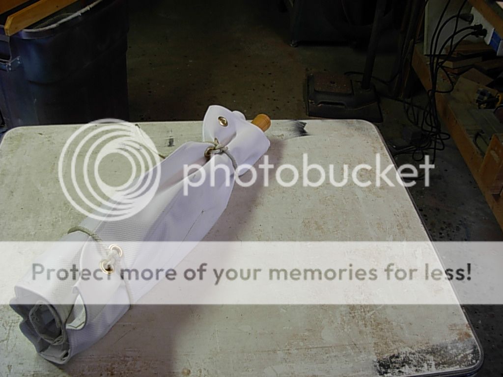

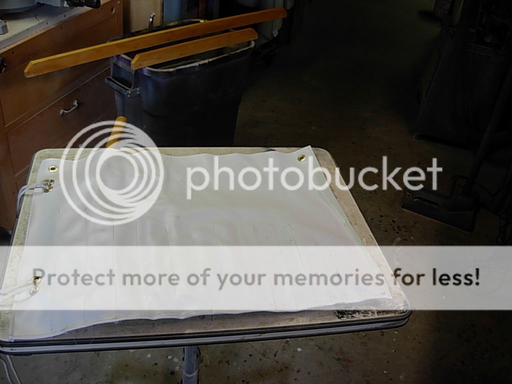

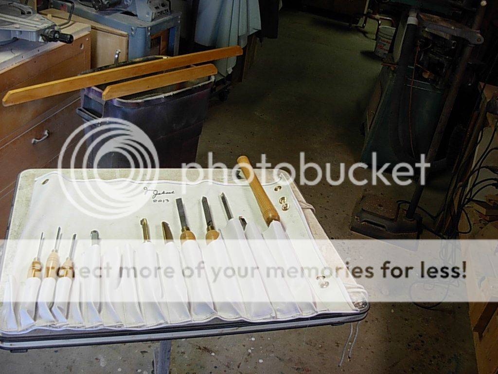

I had an occasion to do a demo of the thread chasers at the W Mich Woodworkers guild meeting last night so I needed some way to carry all my tools without having to throw them in a box so I sewed up this roll up tote.
It is made from white vinyl and will hold 15 tools….....3 gouges point down and the rest point up.
Here it is:
