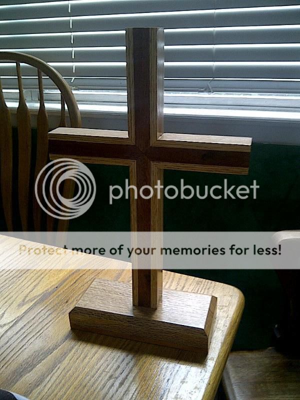

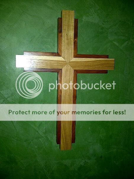

The past two or three years, I’ve made a bunch of crosses for people – some as gifts, some for sale. This was the one that started it all. My mom retired after 40 years of teaching at a Christian parochial school. Wanting something to honor her service to the church and families, a cross seemed appropriate.
This was made with a slab of beautiful oak with no knots and wonderful straight grain that was actually salvaged from a shipping crate. The edge was a piece of wild cherry that was given to me by a friend. I was very pleased with how it all came together, and a couple coats of clear poly really made the cherry/oak contrast pop.
This lead to more complicated assemblies.

Very nice job sir.
I would like to hear more about the assembly as I have thought about making something similar but am not sure about the angles, etc.

This one looks so simple, yet so very elegant. I’m sure your Mom loves it!
Thanks for sharing

Indeed. Well done.
That little hangover of the edging is something I wouldn’t ever have thought to do, but it really adds a lot.

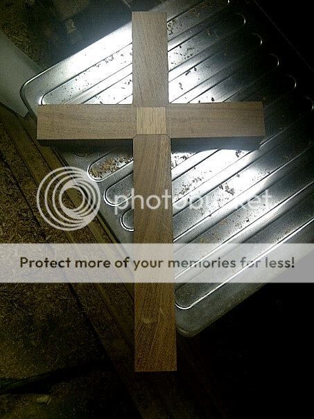

Thanks, all, for the complements.
The angles are cut with a sled. It really is just being willing to “nibble” my way into a cut so the angles meet at the same points perpendicular to each other on each arm of the cross. I also cut dados (sort of a mortice, I guess) into the arms of the cross and insert a floating tenon or key to help hold everything together. Sometimes I hide the dado/mortice inside the arms so it’s invisible; sometimes I leave it exposed like I did here, mesquite with oak “key”.
From there, it’s fine-tuning with a plane or sanding block and a glue-up.

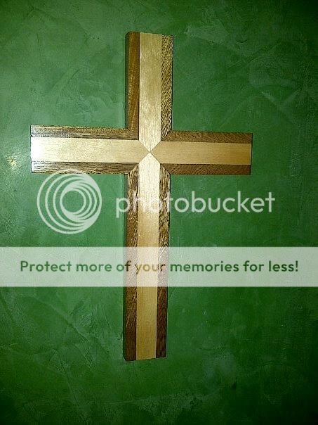

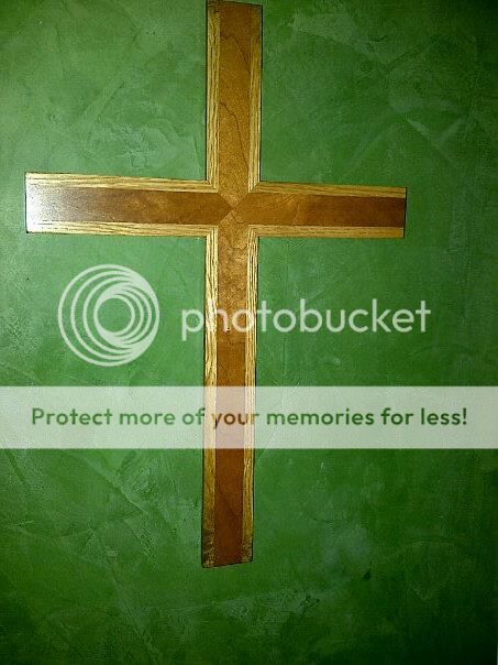

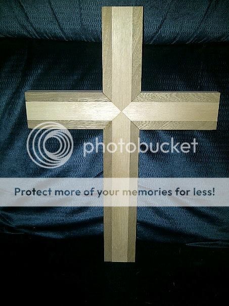

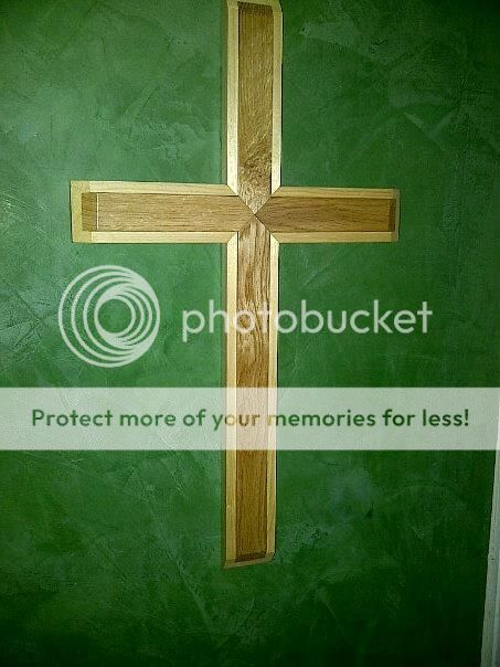

Other pictures of crosses:
I don’t remember the name of the trim wood; the center is oak.
Pine back with oak center:
Oak with cedar trim:
Cherry with oak trim:

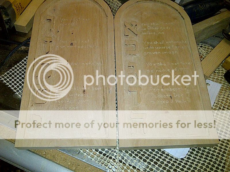

Last but not least, two gifts for a friend who is Jewish:
Cherry. Lots of router and dremel work. Forgot to get a final picture after the poly was applied.

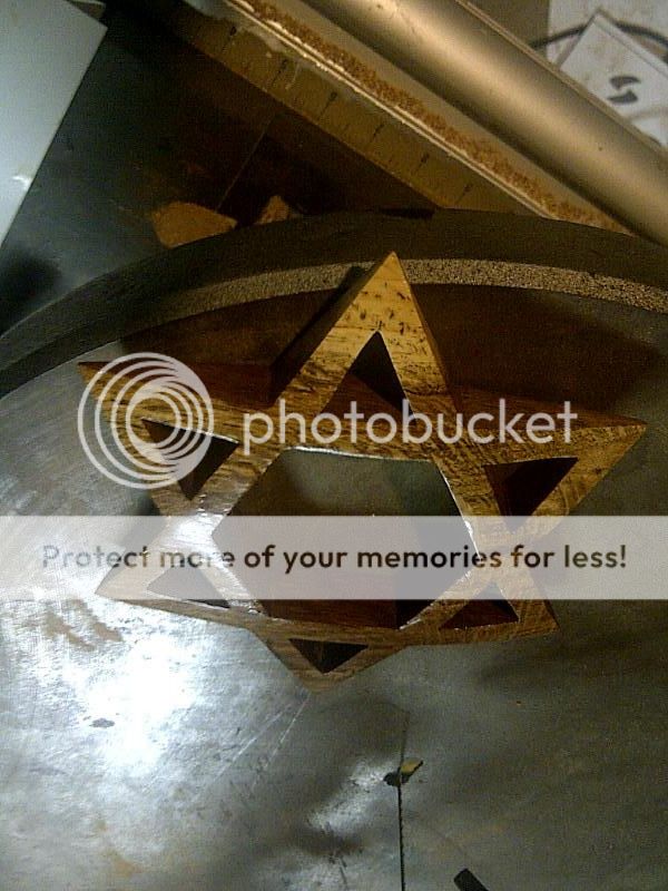

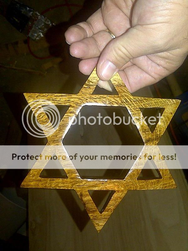

And a 3-D Star of David out of water-marked oak:
