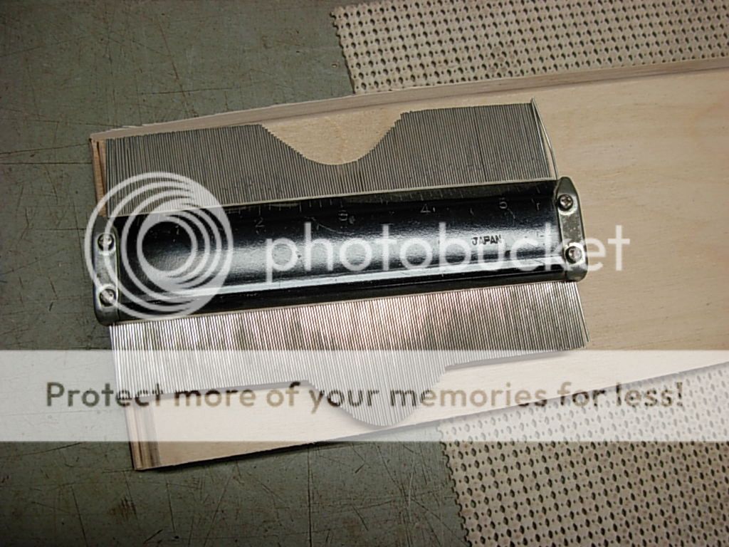

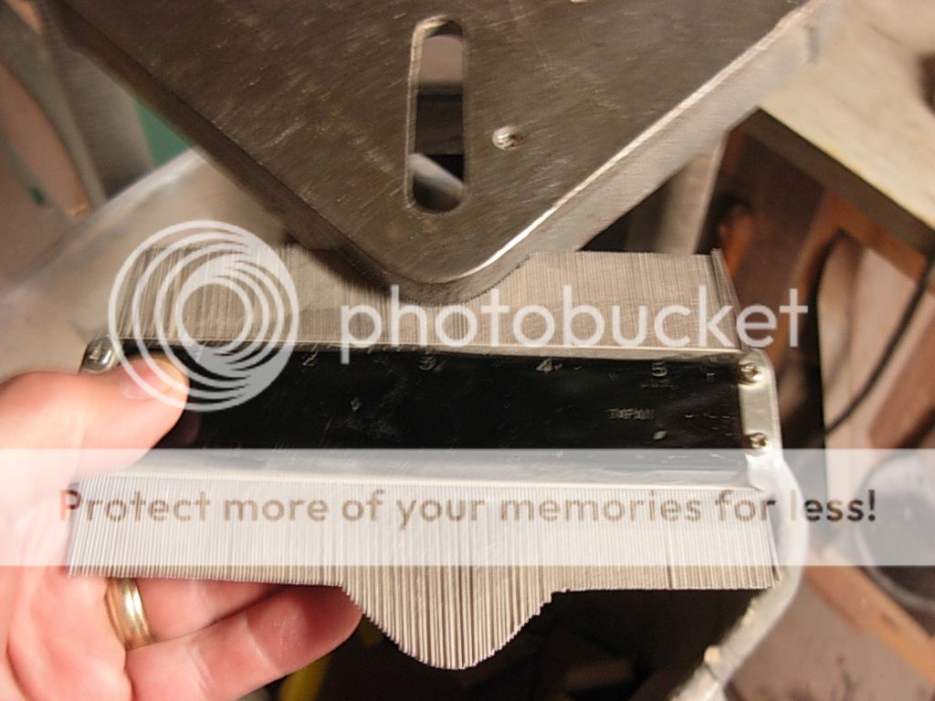

For those who asked about the copy cat. Here is it in its normal state- just a bunch of small round rods:
Here it is copying the radius on my drill press table:
And here it is ready to trace on a mating piece:
