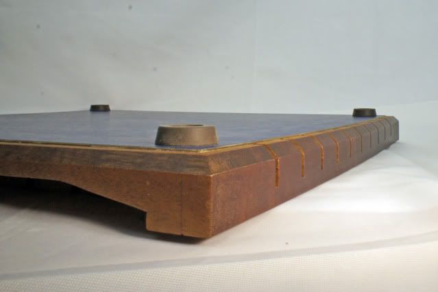

This version, a direct copy of Gigamic’s, the French manufacturer, was made from a single wide chunk of mahogany, the ends nipped off and then dadoed. The angled side planes come courtesy of a raised panel cutter on the shaper.
It was looking good at that stage but all was not well though. After cutting the grooves the board went berserk. It warped terribly. 1/2” in 16”!!? The slots you see on the bottom edge are where I tried to correct it.
After sawing these grooves I PVA’ed a piece of heavy gauge plastic laminate to the bottom and left it in the hard press for two days. Well, no dice, only modest improvement. But at least it’s concave and steady on the corners. The finish is Tried and True with varnish, Goddard’s wax.

Forgot the banana shot.
@Sodabowski – Inlay, banding? Good idea and still possible. Might keep your eye away from the defect. Should have put the mini groove down the edge too, emphasizing the cross grain joint since I can’t hide it.

Man you have an eye for design.
Have to think about what else to do to combat the dreaded banana. Maybe use a two layer build up and only dado through the top layer. The raised panel edge treatment is one I will have to remember.

Neat looking game. Nice design with the panel bit too. I think if I made one(learning from yours, otherwise I’d have had the same problem), I’d keep it oversize, cut the slots, let it sit a week, then plane it flat. Thanks for sharing, and it really does look good.
