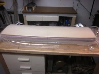

I finally got my new vacuum press in action and started pumpin’ out the longboards. They are a 7 ply maple core with 2 cross grain and 5 long grain plies. The 8th an 9th layer are more decretive veneers. (Japanese Ash, Lovoa, Claro Walnut burl, quilted maple, and bubinga). In stead of grip tape, I use silica sand mixed in with poly for a nice clear grip.

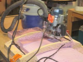

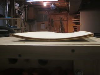

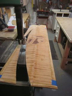

@ Dustin. I buy a longboard set which is 1/16” thick rock maple. It comes in 12X48” sheets (2 cross grain for rigidity). I then form it over a foam mold for a concave shape and also bend the foam from tip to tail for camber so you can “pop” out of the turns. I used to try to bend the board from external clamps, but that would kink the wood, so now I insert the entire form into the vacuum press and let the vacuum do the work.
Cutting the foam mold for a concave shape:
Bending the mold from tip to tail for camber:
The result:

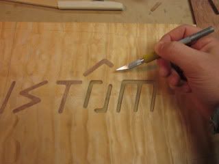

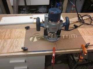

@shipwright:

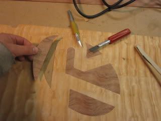

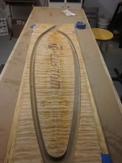

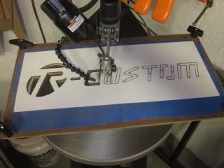

I used a 1/32 router bit. I never thought of using foam underneath (I bet that would have saved me a few bits). I ended up cutting a two piece template out of hardboard. The pattern is cut through both pieces so the inlay just falls down after its cut and the bit only goes through the veneer, so it doesn’t break. Here are some pics:
PhotobucketPhotobucketPhotobucketPhotobucketPhotobucketPhotobucketPhotobucket

Tom, we discussed the foam under router inlay cutting back here: http://lumberjocks.com/shipwright/blog/18834 but it was awhile ago. Not a thing wrong with what you’re doing though. Looks great.

Paul,
Now I remember. I am so A.D.D when it comes to woodworking. My mind is always going a 100 miles an hour. I did solve my “tight radius” problem. I found a local machine shop to make me some router template bushings that were sized for a 1/32 router bit. I also made another bushing with a 1/16 smaller OD for the inlay. I can now get into super tight grooves and make accurate inlay cuts. I love it!
