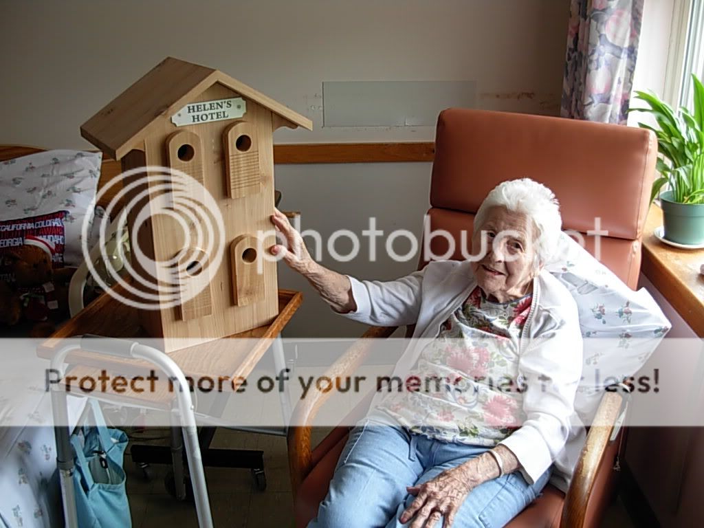

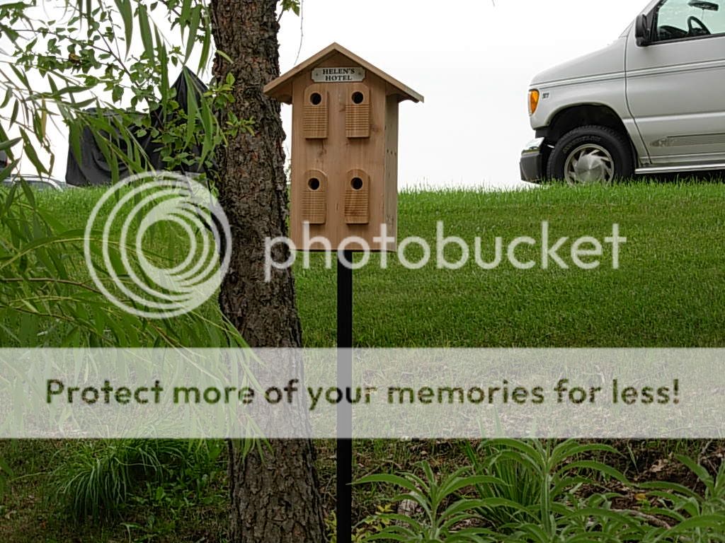

Hi Cher, my mom is a kind of a celebrity at the nursing home now with her own bird hotel. She turns 98 on Tuesday 8-16-11.
Here are the pics of it with her and installed: I have to remember to center the picture to the left more. I cut my mom off in the photo.

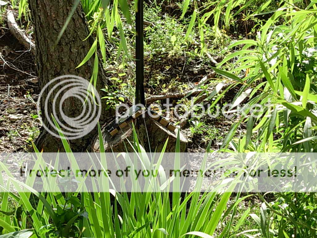

This is the base of it fastened to the tree stump. It leaned a little so I had to cut some wedges locally at a friends house to make it plumb.

Hi Mads, she is there. I found that if you right click on the picture and then hit View Image, it gives you the fulll picture as I took it. I only saw one bird go in so far, but the most action is in the spring when the birds are starting new families.

I had to save the ohoto to see it full…
And sweet she is with her grateful smile.

Hi Jim, thank you for the lovely photo of Mom and the new bird hotel, I did manage to see your Mom’s lovely smile. God Bless you for being a good son. Give your Mom a big hug from me and tell her she is amazing and a very big HAPPY BIRTHDAY. I am visiting my son at the moment and he is spoiling me.
