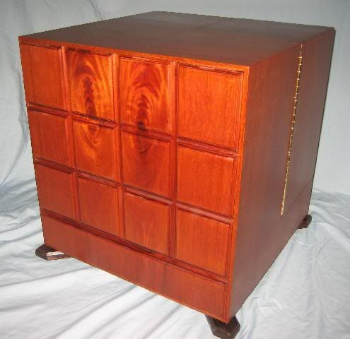

This project took 4 days of thinking and 4 weeks of work. My wife has been after me to make a box to
keep all her cross stitching supplies in. Then the “Not just any Box” contest came up. I figured that
I would kill two birds with one stone. The box is a cube 17” square with the feet height of 7/8” and
extending beyond the cube 3/8” on each side. It will fit into an 18” cube. I made it as compact as
I could and still hold all her supplies.
Materials:
Case: mahogany
Front: Quilted maple, ebony and quilted sapel.
Drawer sides, bottoms and dividers: maple plywood.
Drawer front and back: Peruvian walnut
Drawer face: quilted maple, Peruvian walnut, poplar
Feet: Wenge

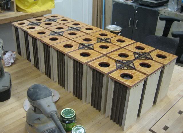

Here it shows all the drawers open displaying the pin joinery. All drawers have full extension wood
dovetailed slides. Like something that has 24 of anything it gets real boring after a while. After applying
336 pins in the drawers, I hope not to see any for a long time. The ends were dyed and dried before
inserting them into the drawers to avoid any bleeding into the maple sides.

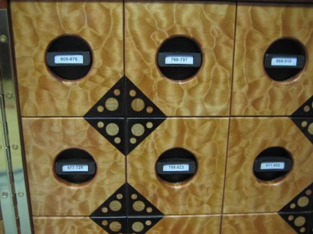

Here is a closeup showing continuous quilted pattern across all drawer faces and the details
of the corners. The corners were cut 1/8” deep and inlayed with walnut. Then 3 holes were drilled
part way through and filled with poplar dowels. The endgrain on the dowels surprised me with how good
they looked once flushed.

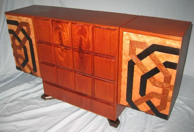

The following two show the back with and without the doors open. Here I tried to made the
back copy the front as far as the drawer layout was concerned.

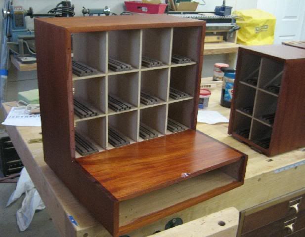

I have included some construction details that I felt might be of interest.

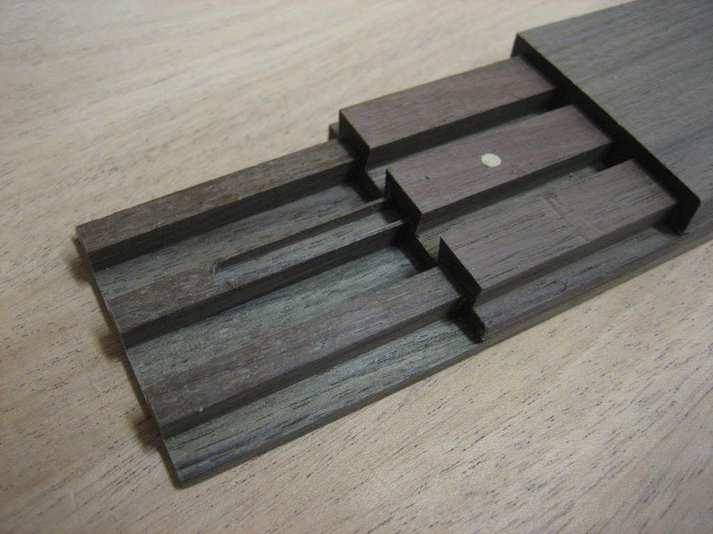

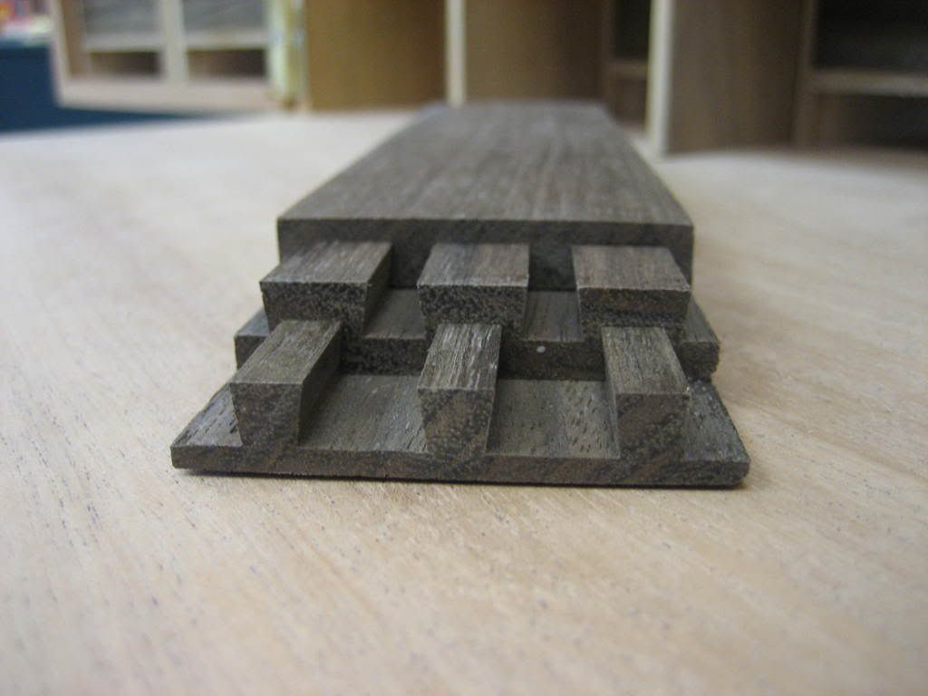

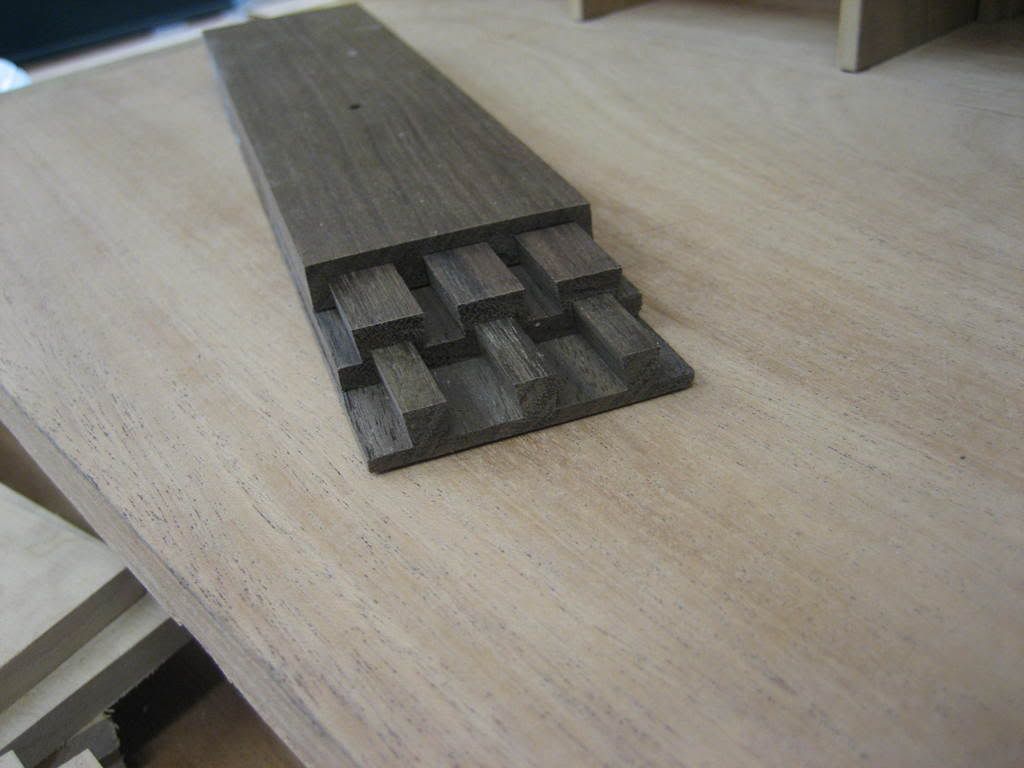

I don’t think I will ever make anything with so many drawers ever again. The full extension dovetailed
drawer slides seemed to take forever!
Here is one
A close up view
How the slide stop was done with a peg
Here is part of it installed in the box:
And the other part installed on the drawer bottoms

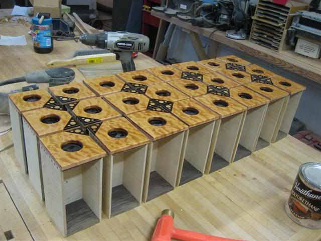

For the front and back of the drawers I also used walnut. For the fronts it allowed
me to drill through the maple to expose the darker walnut.

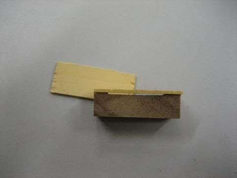

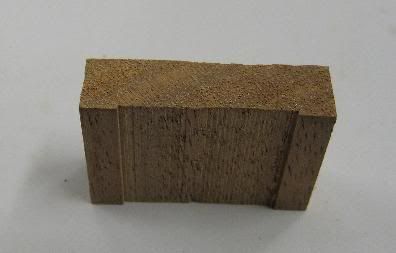

For the drawer handles I drilled through the maple surface into the walnut behind it for a great
contrast. The handles presented another problem. At first I was just going to put little knobs in
the holes, but my wife was going to keep hundreds if different colored thread in there and I wanted
to have it organized so that she could find it easily. The solution was name tags built into the
handles. The slot was the hard part. I started by putting a groove down the length of wood as
seen here:
Then after cutting it into handle sized pieces I glued a thin 1/16” piece of Laotian Boxwood
on it creating the slot for the label to slide into. The boxbood is great because it is strong
machines great, and is splinter free.

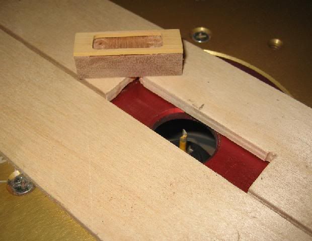

Here it is completed and the fixture I used to route the window.
The last thing is the finish on the quilted maple drawer fronts. To get the quilted figure to
really stand out I used a brown water based dye very diluted to about the color of a weak tea.
The dye really soaks into the wood especially the quilt pattern. Then I sanded off just enough
to leave the dye in the quilted pattern. Then applied a oil poly.
I didn’t want any handles on the box so to keep the doors closed I embeded small magnets in
the case and door. The lower drawer is opened using the notch above it.
The feet are made from wenge, and I tried to make it look like the box was floating.

Man that is incredible – those full extension dovetail slides are genius!

Those dovetailed sliders sure look nice… is there a trick to making them?

Joe – Not much of a trick. I did use an Incra router fence and their templates to do it.
Just a double dovetail done along the length of the piece instead of on the end.
I got the idea at a woodworking show, watching them demo the fence.

precision … what tolerance did you use for the sliding dovetails ?

Nothing specific.
They were a little tight until I rubbed a candle on them. Wax is a great lubrication for wood.
Some I had to run through the router table twice to loosen them up.
Each drawer is fixed so that it won’t slide all the way out so basically each drawer slide is hand fit.

That is awesome good work. The full extension drawer slides are pretty similar to something I’ve been planning for quite a while (if I can ever stop working ON the shop instead of IN it). I’ve got a question on the stops. Are you able to remove the drawers or are they pretty much sealed in there? One poster on FWW’s Knots forum did something with spring loaded stops that would catch the drawer but a paperclip pushed through a pin hole in the sides of the slides would push it down into the DT slot so that you could slide them out of the case. I was mulling about a similar but slightly less complex idea but wondered how you handled it if they’re removable.

Doug. The drawers are semi permament. There is a 1/8” peg press fit into the bottom of each
drawer that locks in the drawer. You just need something to push it out to remove the drawer.
