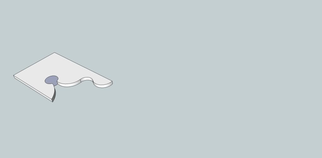

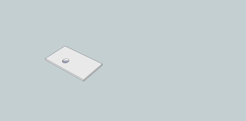

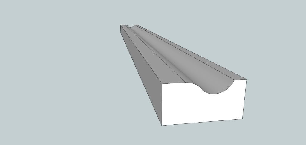

Making ogee bracket feet
Step 1: get a blank aproximately 1×2x24, and route a concave down one of the 2’ sides the complete lent, making sure to leave the top and bottom edges intact (this will later be the face of your legs!
Step 2: From what is not the back of you blank choose the edge which will later become the top of the foot and remove one blade with about 1/16 from completely through (the picture explains it better)
Step 3, cut you blank into four sections, about 6 inches each
Step 4, Make a template. This will be from 1/8” ply or anything else that you prefer. it will 3’x2’. Frirst Mark a spot about 3/4 inch from the long side and 1-1/2” from the short side (the exact measurement isn’t that inportant as long as you can duplicate it later. Drill a 1/4” hole here.
Step 5 Cut the template aproximately as shown with the jig saw(remember the larger side is the top of the template
Step 6 Make the matching holes measureing from each end of you blank (make sure you keep the top in the right direction, once all the holes are drilled place a piece of 1/4 inch dowel in the wholes of the blanks from the rear and use this to align your template, Mark the outlint and cut them in the jigsaw
Step 7 Cut each piece in half making sure to keep them paired. Each set will be mittered together.
I hope this is understandable
