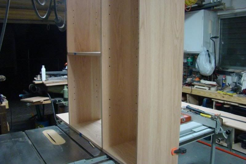

About 4 weeks ago I was going through some of my more recent WOOD magazines and came across issue 180 Nov 2007. I have a lot of 4/4 Red Oak so I thought “So why not build this, what could it take, A week?) So I set off to build it. After a LOT of gluing up 2 and 3 boards to around 13” X 55” then planning them to 3/4” I was ready to start the fun stuff, squaring and dimensioning to the final sizes of the “Materials List” ; not such an easy task! First I thought it was me, and then I thought it was the tools out of square, and then I realized it was the wood. I never saw such movement in wood. It grew 1/16” in a matter of one week, I cut it again then a week later is was 1/8” to short, so I glued up a few more plus some extras. Well I checked and tweaked all my tools, sharpened my chisels now I was ready to do battle with the Red Oak. I am posting some photos of the first dry fit I did plus some photos of the Rough sawn lumber (Red Oak) I am using for this project. After I get a little closer to completion I will post some more for viewing. I sure hope this thing comes out good. I have learned a lot doing this project and the education has been valuable thus far.

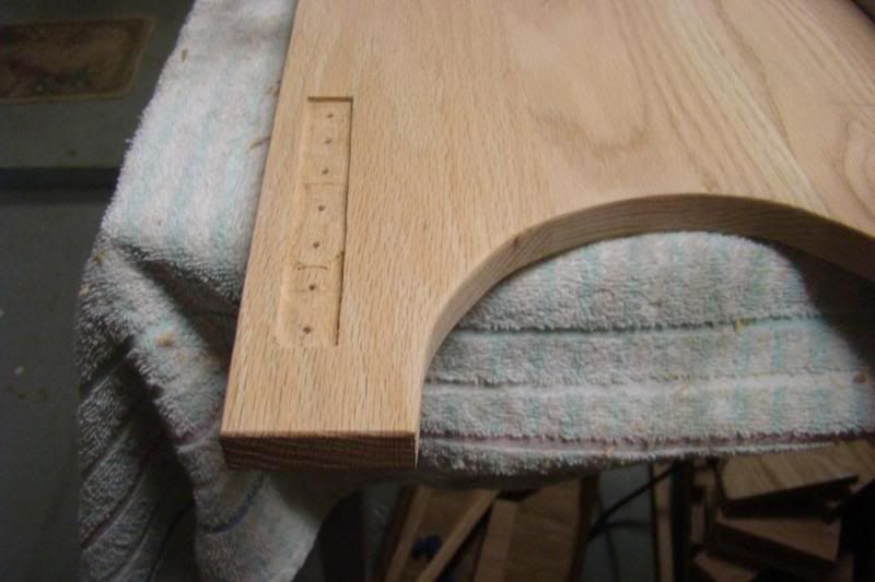

I got some shop time in so I thought I would post some more pic’s of the progress. The weather has changed a bit and everything went back to what it was when I cut it but only after it was sanded and wiped down with mineral spirits I guess the sanding operation helped the boards fit better in the dadoes & the rabbits are all on the back so I am not real concerned about those. I logged on to http://www.woodmagazine.com/fairing to see how to make a fairing stick so I could make the front and back arches and really enjoyed using the band saw with the ceramic guides http://lumberjocks.com/jocks/sandhill/blog/2071 I had a post about them and how they worked for re-sawing, which works well for me. So here are the photos as promised.
Photobucket!
Part of the case glued up
Prepairing for the faux tenons
