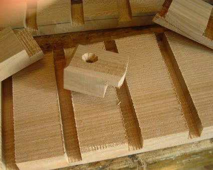

that looks lovely. The grain really came out nice with the oil finish. How did you attach the legs/apron to the top? I’m getting ready to make a few small living room tables and am considering how to attach the tops.

Betsy – The apron is mortise and tenon jointed into the legs. There are two elm pegs driven through each of the joints.
To allow for movement of the top,. I attached it with elm buttons like so:

Very nice table. I like the contrasts in the color of the wood. Very interesting technique for creating the buttons. I learned something new!

thanks – I’m considering buttons for my end tables your method of making them gives me some ideas to work with.

Stewart that is a beautiful table. I like the way you used the elm buttons for securing the top.
