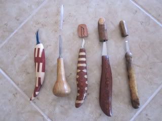

One of the first things I learned about carving was that you have to have sharp tools. (this was closely followed by learning that you need a carving glove and a supply of bandaids). Many carvers struggle with sharpening their tools, so it is somewhat easier to start with a blade that is already sharp and then just stropping and honing it to keep it sharp. The Stanley utility knife might seem too ungainly for carving, but it is really a great knife. The blades are sharp and can be made sharper by stropping and they are cheap to replace if you nick the edge. The thin blade also slides through wood very easily. Although I use the Stanley extensively, the blade is too big or too wide or the wrong shape to do certain things or fit in certain places on a carving. So I made my own knives for about a $1 a piece. I purchased Excel blades (http://www.excelhobbyblades.com/index.php?cPath=46_82 ) at Hobby Lobby. They were already sharp, but I tired quickly of changing blades in their handles, so I made my own handles in various styles and shapes. Making your own handles allows you to experiment with shapes and sizes to find what you like. I am currently fond of the Mike Shipley style handles that are long and straight (they are surprisingly comfortable). Simple get a small square of wood and drill a 3/8” hole in the end about 1 1/2” deep. Cut a slot in the end of a 3/8” dowel and cut it off so that it fits in the hole. The tang of the blade fits perfectly in this size dowel! I use belt and drum sanders to shape the handle and then use epoxy to glue the dowel and blade into the hole. Very simple to make and the blades are already sharp and easy to keep sharp. The blades are about $1 each in a package of three, so if you don’t like the handle or you want to reshape the blades, you are not out a lot of money. I have used the knives quite a bit over several years and they have held up well. You could easily use the same process to make marking knives for dovetails or other purposes.

Hi Mike, I also use home made gouges and knives. The blades you show I have also made and find they perform quite well. A friend in the local carving guild gave me a small piece of what he called cobalt steel. All I know is it took 3 hours to sucessfully grind the metal to a useable blade.. They seem to be my favorite knives to use as they rarely need to be stropped.
I wished I had thought to use the dowel when I made some of my first knives from the Warren blades, I would have saved lots of epoxy.
The gouge on the end was made from the thick part of an old butcher knife, and the second gouge was made from a drill bit. Its one of the most used tools I have to get to the small places.

Mike, those are very similar to the knives I use and I also have another that i made from a saw blade used to cut steel that is about 3/32 ” thick. Since I was a welder, I had access to equipment that I used to cut and shape the blade to the desired shape and once sharpened, it holds a fantastic edge! I shaped it with a blade about one inch long pointing downwards at a 45 degree angle and I have a tool that is great for roughing out my cuts and it works pretty darn good for chip carving as well. I don’t do much chip carving as it is just too tedious for me, one li’l slip and it is very tough to hide your goof ups!

Hey Mike what is the rough size of the handles before shaping?

#13 posted 12-15-2010 06:38 PM
about 3/4” square by 5” long.

I have made some good knives from template stock that is high carbon steel and heat treatable. A piece of template stock is around 3” wide and 24 ” long and is a about 100 thousandts thick. Before it’s heat treated you can cut it with a good hacksaw blade and file it with good files. The template stock costs about 10 or 15 bucks but that will make a lot of small knives.
I will also say that I have a few manufactured carving knives and also a few v-tools, gouges, and veiners that I like a lot as well. Most of my carving tools are Henry Taylor, Pfiel, or Hirsch. The Henry Taylors are beautiful tools. The others are also beautiful. You can get various shapes (squares, rounds, flats, and rectangles) of high carbon steel from McMaster Carr#. I haven’t made any knives for quite a while nor did I ever make over a handfull but it wasn’t that difficult to heat treat them and they worked pretty well. I encourage anyone to give it a go because it’s very satisfying.
