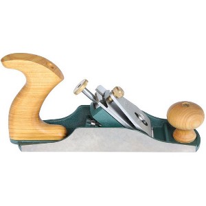

My bet is that it is a Kunz. It is similar to this one
http://www.highlandwoodworking.com/ProductImages/handplanes/179819.jpg
Kunz Plane
The depth adjuster is a bit different. Yours having depth and lateral control from each side, the newer one having depth and lateral separated.

My guess would also be Kunz, but it is a copy of a Stanley (as is almost everything Kunz makes). The mechanism is almost identical to that of a Stanley #151 or #153 spoke shave. As you can see from one entry, it has also been adapted by Stanley for a plane. It is not known as one of the better Stanley planes, but if it works well, who cares. Remember, the tool is not the goal, the finished product that you make with the tool is the goal.

Um, after looking aroung a bit, and mind you I am no expert, but I agree that it is most likely a Kunz plane. The “Made in Germany” is something that they actually stamp in their planes as a bit of “German quality pride” and use this as a marketing tool to show that their tools are well made. And when you look at advertising from their tools they include it in their advertising.
The company still exists and making quality tools. The company goes back to 1910 in the eastern part of Germany However the number 3 plane is nowadays made with a plastic grip. As already stated above they have not changed the shape of the grips in many years, so this is also what leaves me to believe this is a Kunz. The cutting irons have changed a bit throughout the years, and this plane could be pretty old, so its hard to say. Sometimes if you look at the iron, the “kunz” might be stamped in to the steel. Check out this link: http://www.holzwerken.de/museum/hersteller/kunz.phtml

and I think I have found the model, it looks excacly like model 300
and they call it a Special plane for working with artificial wood plates, alone or glued to boards, or plastic
