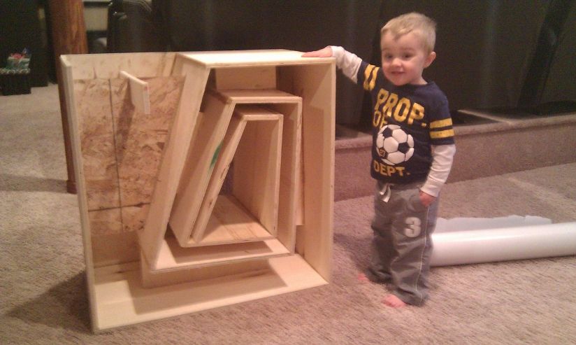

I built his Table Tuba and am using it in my home theater (http://www.billfitzmaurice.com/TT.html). Corner loaded it is pretty loud. Does a great job down to around 30hz. I have a 15” folded horn I use for the sub 30hz.
Here is a pic of the folds in the table tuba along with my helper.
It looks like you did a great job on the builds! Thanks for sharing!
