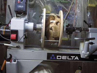

Here’s a technique I have worked out for building the pieces and assembling them for segmented vessels.
Segment bowl technique.
With X-mas comming I thought it might help somebody.
Cheers

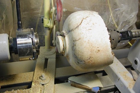

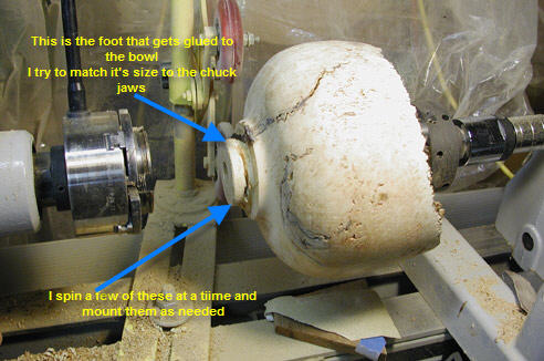

Hi Doug:
I think I mislead you with that picture.
Here’s what the glued on foot looks like:
The part I glue to the bowl structure would be the very top circle.
The reversed mounting jig looks like this:
In this case I have it mounted on a set of “coles jaws that will accomodate the long screws shown in the picture. the mounting “jig” is just 2 pices of 3/4” plywood with a tapered hole cut in the working end and lined with weatherstripping felt to prevent marring.
Depending on the vessel you may need different openings on the working side.
It is in essence a “cradle” to hold the finished bowl in reverse.

Say an now that I get to looking at the picture a bit harder, what is that hanging out of the tailstock?

Doug, the picture is out of sequence but shown to let you see the donut thingie.
If I remember I used the black coloured chuck to hand off the bowl to the donut to keep eveything centric.
I probably attached the tail chuck to the tenon and snuck up on the final parting using the tail chuck to stabilize the bowl until the last cut.
It’s an old trick that I use often when coreing out bowls .
I leave a center piece in place and attach the tail chuck to it to stabilize the wood as I hollow out the bowl.
