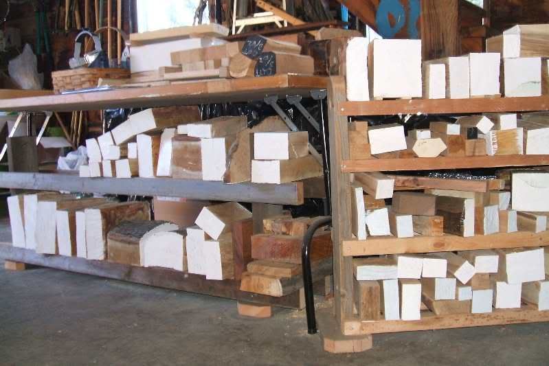

Great vase, and a fine collection of blanks too!
