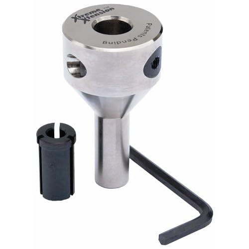

By the way, I also use one of these to raise the blade higher for the upper keys:
