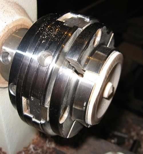

You did a great job on that. One thing I learned about my nova chuck is that the jaws (depending on the set you have on it) are tapered. If you taper the wood to match, and dont let it bottom out (make the tenon longer or as long as the jaws) it wont slip. I tossed more than a couple cups, bowls, and whorls across the garage, before I learned that. Actually heard it on the woodturners workshop show, and said “duh…”
Keep up the good work. You can do a lot on a Jet midi. I know, as that is all I have myself.
Looking at the picture, it looks like the tenon holding you piece to the chuck is flush with the bottom, and has no shoulder to support it. You would be surprised on how short a tenon will hold if you have the angle on it right.

Nub
This is the nub of a 8” long x 2” wide piece of maple that I had in my nova chuck, to turn Christmas ornaments.
This is how it sits in the chuck, you can see a gap at the bottom, so the wood is not bottoming out, and the jaws are supporting it. That way if you snag, it is less likely to knock the wood loose. Notice I left a bit of a shoulder so that I knew that it would not bottom out, and it helps with support.
On expansion, this is all the lip you need to hold very small stuff. (I would want much much more for anything heavier than this 1/2oz piece of wood)
