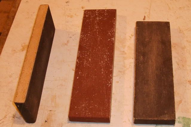

Since I barely use mortise and tenon joinery in my projects, the purchase of a shoulder plane is not justified. Too expensive. However, to get appropriate joints without such investment, I came up building what I could also call a shoulder sander.
The strip of sandpaper is simply sandwiched between the two blocks of wood with the two screws.
It is essential that one edge of the sandpaper be flush with one edge of the blocks of wood to be able to sand flush to the shoulder.
The remaing sanding strip, non used, overhangs on the opposite side. The unused part of the strip can be repositionned or pivoted to get new fresh and clean grits.
Not my best device, but this is an easy to use cheap tool to get more than just safistying results.
To read more about it, check this page of my website.
Best,
Serge

13600 posts in 3310 days
#8 posted 03-29-2010 12:50 AM
heres what i use ,
sanding belts ,
around a block of wood .
makes a great rasp ,
for corners and chamfers too
!http://i607.photobucket.com/albums/tt158/allheartojo/SANY0120-7.jpg

Great idea, what i been using for a while now, and everybody probaly knows it by now is carpet tape, it is sticky on both sides, you can put it on a flat board or dowels or even on foam then place your sand paper on it. It works very good.

David, you also have a great way to go too. However, since these boards are quite large, I’m afraid they would have the tendancy to tip over on a short tenon. Am I right? Using yours on a flat surface should be great and fast. I’ll try them.
Best,
Serge
#13 posted 03-29-2010 10:15 PM
it’s like everything else we do ,
easy does it .
