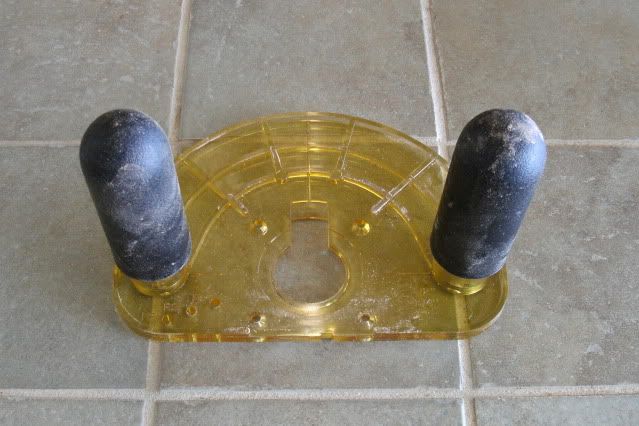

Trim routers are great tools, but the base is so small that they have the tendancy to tip over when milling edges. While one hand holds the router itself and steers, there is not much room to grab the tool with the other hand to hold it flat. And when holding such small narrow base, fingers are too closed to the spinning bit!
So, I made this accessory base plate. I used a piece of 3/8”-thick Plexiglass, about 6” by 11”. I made it wide enough to give a broader surface, room to place the handles and my hands, but small enough to prevent the Plexiglass from sagging. I used 1/4” flathead bolts and threaded inserts to install the handles, which are 1-1/4” hardwood dowels.
Great tool, with this great base !
For more details, pictures and a short video on drilling Plexiglass, click here.

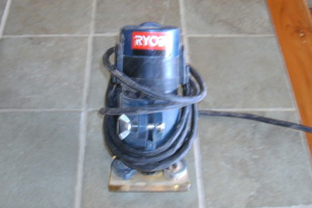

i have 2 of them ,
that came with my
ryobi trim routers ,
$79.00 apiece !

router and base in same box .
use router with or without the big base .
$79.00 .
only at home depot .

serge , here is the ryobi ,
the big base has some features that might help ,
some offset lines for grooving ,
and some holes for circle pins .
