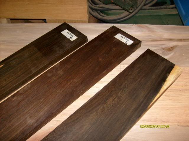

Thanks for the advice norwood but I’m gun shy now and I don’t think I’ll be resawing this wood again. For the record, I snapped a couple of pictures of the remaining boards.
Pau Pic 1
This shows the color but it’s not as dark as real life. I can’t get the lighting right to capture the wood as it really looks. Just imagine a darker shade or two and no grey shadow spots. The board on the right is the one I took the box top and bottom from. You can see the sap wood streak down the side just like the box.

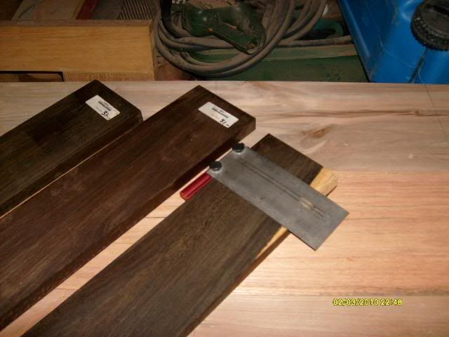

Pau Pic Plus Incra Ruler
This shot shows my handy dandy Incra ruler across the width and if you zoom in real close maybe you can see it’s just a little over 5”. You may also see the vendor’s tag – Rare Earth Hardwoods – one of the best online sellers I’ve used over the years.
