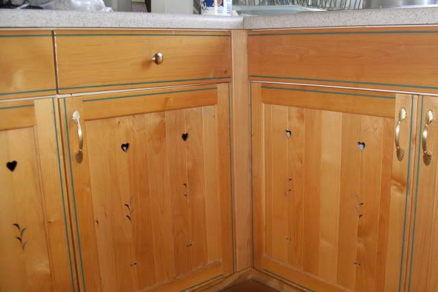

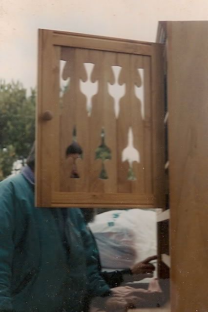

janice ,
i make all my doors with the table saw and dado blades .
all my panels flat ( cheap is just 1/4” ply ),
or mostly i split my 3/4 wood and plane it to 1/4” ( saves wood ),
and either make little cut outs on the edges or cut shallow groves and paint .
rails and styles i grove in the middle for 1/2” by 1/4” wide .
the rails have a tenon 1/2” long , 1/4” thick .
with the same 1/4” dado set up ,and the fence set to 1/2” ( from fence face to outer edge of blades ) .
i sneak up on the thickness of the tenon by raising the blades little at a time ,
until i get a snug fit .
if you don’t understand this , write me and i will make some dawings and explain better .
