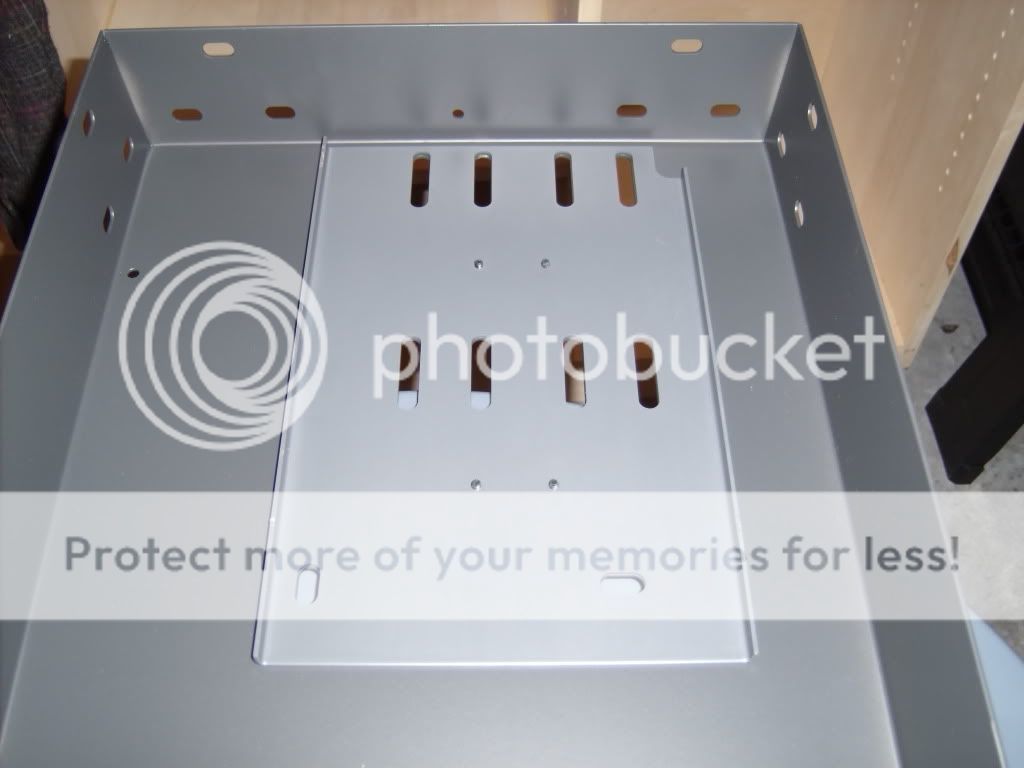

#10 posted 1021 days ago
bsherman & anyone else with a Ridgid band saw, did the table top that came with your saw have an additional metal brace (drilled to for motor mount and saw frame) on the underside? Below is a picture of mine, bought in July 2010.
Thank You
View bsherman's profile
bsherman
76 posts in 1698 days
#11 posted 1021 days ago
Yes. Mine did.
