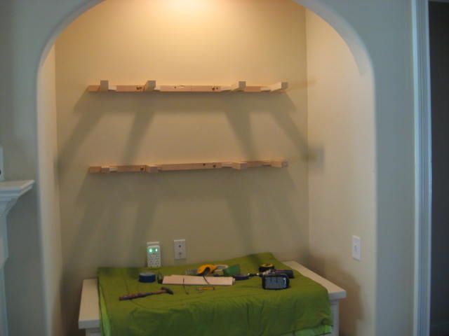

The Shelves are simple boxes sanded to 320 grit. The finer grit kept the walnut stain from turning the unruly pine dark brown. I used 6 coats of Minwax wipe-on satin poly. I had used it before on smaller projects but didn’t trust it enough with 3 coats. My intention was to give the shelves a hard surface. Maybe it was overkill but I kept thinking “It’s soft pine. It’s going to scratch by breathing on it.”
Each shelf was built with a bit of a study support structure inside that allowed me to shove the shelves securely onto the frames I attached to the wall.
Mom had an extra surprise for me when I installed the shelves. Mom wanted to hang some antique wall sconces above the shelves. I wasn’t thrilled about that but I made it work. I didn’t have enough time to run electrical so I had to cut tiny triangles out of the corners and couldn’t run my support structures into the corners. That added a bit of effort. The corners were scribed and sanded to fit the shape of a household right angle. ;) It took less time than you may think.
Mom asked how much weight she could put on the shelves. I told her to keep the center shelves to under 30 pounds and the longer shelves to under 80. Her jaw dropped.

A picture worth a thousand words:
The frames were glued and screwed.

I’d like to see more of the stuff mounted on the wall that you slide the shelves on.
... possibly a little detail on the Box shelves too if you can…

I don’t have pictures but I can surely show what I did with paintbrush. I’ll knock that out tomorrow.

Let me know if I need more “How to” install. If you have some additional suggestions for strength or believe it was overkill, Please share. I’ll tweak it.

Hi Mark... Only if you can without too much trouble...
Show an idea of what the Wall Side of the Shelves look like…
... as well as the supports that are mounted on the wall…
I noticed, today, that Rockler selling the hardware for the Wall supports… Is this what yours look like?
Thank you very much…
COOL work!

Nice looking ”floaters” and inventive mounting system!
I like this idea because it is similar to how mounted my fireplace mantle shelf.
I my case I wanted the shelf to float to get around a massive looking fireplace so I used two 12” angle irons mounted to the front of the fireplace, made a shelf out of two pieces of MDO (it was to be painted) separated with spacers to accommodate the iron angles. I tapped the holes in the iron angles and held the shelf on the irons with screws from the bottom of the shelf.
