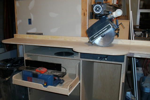

i posted this as a project , because it really has been .
after blowing all my money on wood to augment the rosewood from bibb and deni ,
all i could do was start cleaning my shop , as all my tv and internet was turned off .
this happened 7 days ago .
saturday i was surprised to see my friend doug , ( currently he has joined LJ’s ,but i don’t know his handle yet ) .
drove in to my yard with a trailer and this crosscut saw on it .
he said i could have it , as it took up to much room in his little shop !
it didn’t have a top on it , and the box it was mounted on was pretty bad .
i’m not one of those guys that are afraid of crosscut saws , as i have used them most of my 45 years in
woodworking .i got some money from 1 of those boxes with the art splines in it , and ran to blue box and got 2 sheets of 3/4” particle board for $40.00 .
i made the cab out of one of them , and the top out of the other .
i had to tweek the top , as the arm wouldn’t quite come to square ,
i never move the arm or cut up my stop . but as you can see , i turned on the saw and let it down 1/8”
into the top , and ran it all the way out then pivoted it to cut a semi-circle and then plowed back to the fence .
this way i can crosscut or rip ( when the table saw is tied up ) , without raising the saw .
the saw is totally inside the table edge , so it isn’t exposed at any time .
i made the right side drop down , so i can get around my workbench , and plan on making drawers for the
cab , more storage .
i will make a designated dado jig , that rides higher than the fence , so as not to cut into the fence .
and do miters from both sides with pivoting stops .
all of this in preparation for the projects using the rosewood and the curly maple ,
i want to have the tools in good shape , and everything where i can find it .
most of my mistakes come from rushing , and rigging some other way to do something , cause i can’t get to the tools , or find supply’s i already have .
thanks , please work safe .

i been out there for a week ,
getting up from 1:30 to 4:00 every night !
i did get my 13” belt sander on wheels ,
and the 13” planer also .
now they are out of the way against the wall .
it opened up a space in the shop floor about 8’ x 10’ .
but i’m still only 1/3 rd through cleaning .

when i’m in a project ,
the tools may have jigs on them ,
so i will use the RS for crosscuts / rips / dados / miters ,
so i can make any jigs the projects require ,
without messing with the other setups .
as stated ,
i made sure the arm is 90 deg. to the fence ,
and will not ever change that ,
i never cut my fence but once .
that is where a lot of the problems with RS saws came from ,
guys moving the arm for miters and compound cuts .
they never made a dedicated table for them ,
just whacked the one that came with it ,
until they were trashed , and dangerous .
as i make more jigs for it ,
i will post them here .
a radial arm saw is just like any other tool ,
set up right , and used correctly , it’s a joy !

here is a drawer made with this RAS ,
to hold a 4” toy jointer i got for small inlay parts .
i can pull it out ,
( it will have a lock and vacuum ) ,
and slide back out of the way !

my clamp rack is a result of working in different cab shops
over the years ,
they all had a mismatch collection of worthless clamps ,
and they were always jambed up with glue and the screws hard to work .
stop and clean the shafts , and un crank the screws ,
by the time i got the clamps ready , the glue was allmost dry .
so i made myself a hanging rack , where all the clamps are allways ready ,
i leave 1/4” of thread open , and run the screw down the shaft ,
so they are ready to slide into place and tightened without wasting time .
i set them up before i put them in the rack , when i got lots of time to work them .
the rack is on casters , so can be moved to the work if needs be .
they are in slots , and can just be grabbed quickly.
for the pipe clamps , i got couplings to make them longer as needed ,
i had to make a 40’ one once , and it sure helped !

Hi, fun projects here. Ho do you support the right side in the”up” position? The clamp rack is the best I’ve ever seen. Have any other cool space saving tips in your shop?
-- Bob A in NJ
2378 posts in 234 days
posted 64 days ago
right now it has a stick under it .
when i get further along ,
i might make a swing out ” knee ” for it ,
or a diagonal brace on stops .

here is a mitering board jig ,
all my jigs have dowels ,
to register them .
these have corresponding holes in the table
for that .
this board i left enough room behind it for
a dressed 1×6 ( 5 1/2 ) to cut stock ,
without moving the miter .
you can make a series of table holes ,
front to back for wider miters .

As already mentioned, I recently relocated my RAS in the shop. Finally I completed the dust collection at this new location. I’m sure you’ll be glad to take a look at it. Not 100%, but I’m satisfied so far : 3” PVC pipes and a piece of cardboard box as a shield.
RAS DC 1
RAS DC 2
Best,
Serge
