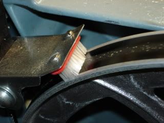

Inspired by a posting by Greg Wurst http://lumberjocks.com/projects/19465 , I was motivated to spend a couple of hours making a set. Using some 22 gauge steel I fabricated these brackets and fitted them to my delta blade guard mounting bolts. This is a firm mount that won’t bounce loose behind the guard. The tooth brush idea works using medium stiff brushes. Hope that this inspires others here and thanks for the idea Greg.
Thanks for looking…

I don’t think this will last too long a toothbrush is designed to last (when brushing teeth ) 3 weeks believe it or not ,so it will probably go out of shape quite soon.I hope not.Alistair

We’ll keep you posted as to how long the brushes last.

Did you screw the tooth brushes to the brackets?

Nice idea…and sharp looking brackets…..I would agree with Alistair on the brushes not being durable though….
I wonder if a finer wire brush might do the trick?
Let us know how it works out…if the toothbrush works out….I have a ton laying around…I even see a lot of them at the dollar store….would be a nice inexpensive upgrade to the bandsaw.

It’s been 6 months since installing the brushes on the bandsaw and thought an update is in order. The tooth brush works great; no scoring of the tires, while cleaning very well and no visable wear on the bristles. I think I’ll put a tad bit of pressure on the brushes as you see in the photo below. Otherwise with the combination of dust collection and brush additions have made me very satisfied.
