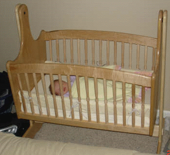

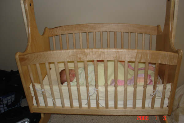

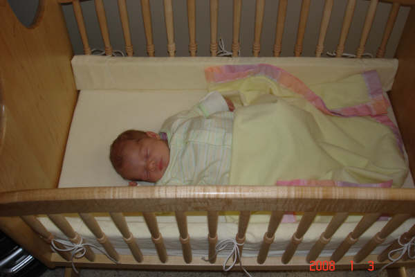

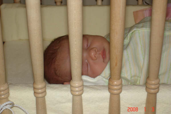

I made this cradle for a great friend of mine. This is his first child. I got the plans from another friend who bought the plans and build a similar cradle. I really used the plans as a guideline for function, but I made all of the curves and spindles on my own. I really wanted to carve their initial either into the cradle or as an applicay, but the baby came a little early and I was luck to get three coats of finish on it. It is made from maple and 1/2” birch ply for the bottom. I bought the swing hardware from Rockler for about $10. I honestly don’t remember what I used for the finish, but there was no stain. All of the spindles were turned on my lathe, the tricky part was that they were several sizes of spindles because of the curved top rail and trying to make sure that the middle detail lined up on each. No picture of it, but I added the quarter from the year it was made on the bottom.

Great looking cradle. And a happy baby.

You’ve done a very professional job on this. The elegant spindle turning is simply excellent ,and the rest of the cadle is also first class workmanship .As a new grandad I can see why your friend is getting so much fun from this lovely heirloom, which could still be in use in a few hundred years, and will be fondly talked about and utlized with love during those years regards .There is simply nothing better in my mind than a hand made offering like this . Alistair

Maple can be hard to get a good finish You did a nice job Even the baby likes it.

Great job. I like the curves and spindles. What patients to turn all the spindles!
I have made four similar to yours and the one problem I did not satisfactorily resolve was locking the bed in place when you do not want it to swing. One problem is when the baby rolls around the bed will tilt and trap them to one side. A dowel or pin from the upright into the bed works fairly well.
One feature I did use was threaded inserts and bolts on the rails and the stretcher so the cradle could be disassembled and stored flat. Much easier to keep as an heirloom when it can be easily stored.
