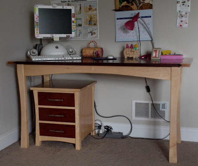

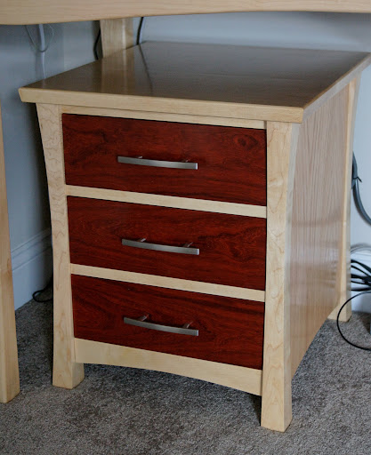

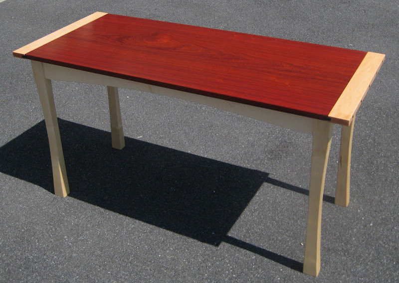

I obviously see a lot of problems in these 2 nightstands but I loved building them. I started a new bigger project: a desk for my daughter in Padauk & Hard maple. The top is in padauk and the breadboard in white maple. Same for the drawers (front: padauk, sides: maple).
How do you avoid color leakage from the orange / red padauk onto the white maple?
(should I take some pictures and present it as a new project?)
