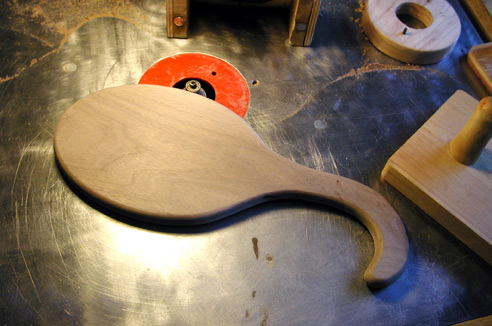

A light skip around the router table witha round over bit and we are starting to see daylight.

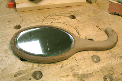

From mirror oval
The mirror seems a good fit and the bezel looks relatively even round it.
From mirror oval

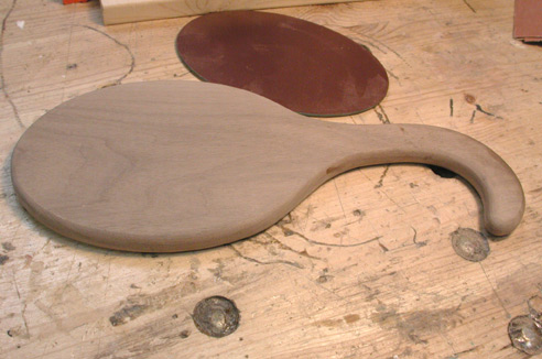

here’s the back with the mirror out on the side.
I am contemplating an inlay for the back to kind of dress it up a bit.
From mirror oval
